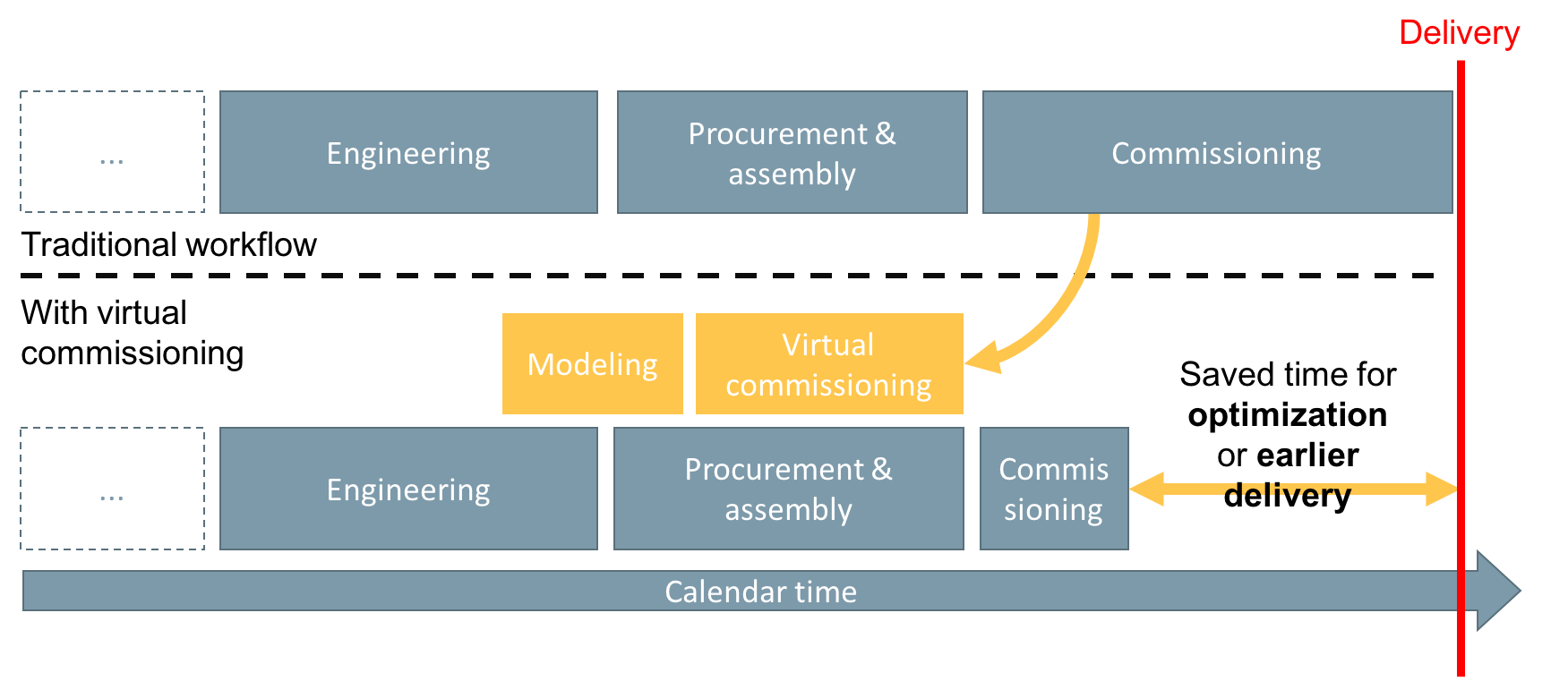

Virtual commissioning provides a solution for moving a significant portion of commissioning tasks to an earlier phase of the project, away from the critical path. In virtual commissioning, a simulation model of the system is created to replace the real factory. The virtual factory is then connected to the real control system, so that the simulation can be used simultaneously with the procurement and assembly to verify the design and test the control system. This allows for quicker detection of possible errors.
Figure 1: Engineering project with and without virtual commissioning.
